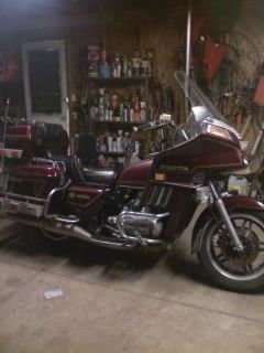

I just purchased a gl1100 interstate wing without a title to fix up. I look up the VIN to apply for a title and it came back as a '82 CB900C, not a 'wing. The VIN is 1HFSC040XCA****** It is obviously a complete wing, and looks like it has always been in this frame, everything lines up perfect. Is it possible that someone could have done a complete swap to a CB900 frame, or is it possible a mistake was made somewhere?
Here is how the actual VIN comes up once typed into the VIN tool at http://www.motoverse.com/tools/vin/honda.asp:
If the 7th digit was a 2 instead of a 4, it would be a goldwing, but then it throws off the checksum making it not a valid vin, as shown here
