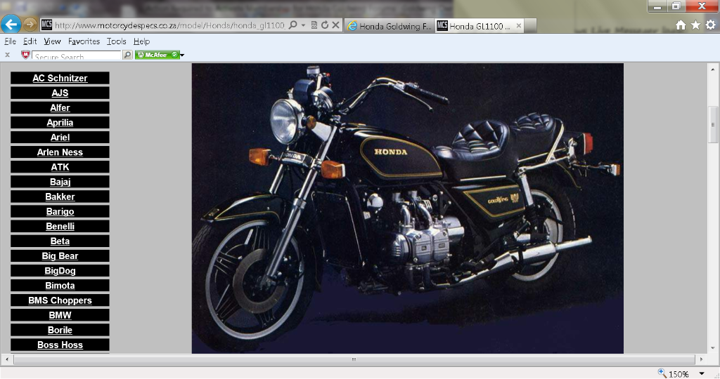

I am starting to wonder what the bike actually is. I bought it as a 1981 GL1100 standard. But it has 18" front tire and 16" rear which differs from the specs I get when I do a google search. Apparently it should have 19" front, 17" rear.
The speedo is in MPH so I assume it is a US bike.
Is there a way of telling exactly what I have via the VIN?

Check the 10th character in your VIN, it will be a letter: A='80, B='81, C='82 etc

Glad you got it figured Brian. The '83's were easy to distinguish, theuy had solid spoke wheels (Comcast) rather than the Comstar 2 piece spoke pattern of previous vintages.
