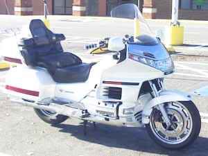

I was out doing some work to my bike today (installing floorboards, levers, exit grilles and a cruise switch) Now I havent had the bike long so I'm still learning all the controls and stuff. (I even learned how to turn on the radio, lol) but here is the question. I purchaced my bike rebuilt and it had been in an accident that took out the fairing, one saddlebag and trunk. Now the bike has the antenna, and wiring for a CB bit the head isn't there and the hole has a cover. I have a switch in the key cover that is some sort of volume pot. switch (I've seen enough of these in my guitars to know what it is and it has six wires going to it. I think it may be a fader switch for the speakers. It has rear speakers(that work) and the harness looks as though it once went up the left handle bar. When I took the key cover off to adjust the handlebars I broke the wires off the switch. Radio still works. Now my insurance company has it listed as a 1999 SE. The last owner when he had it repaired and painted took off all the emblems except the GolgWing emblems on the side covers. (I like that part) so how can I really tell if it's an SE or Aspencade? The trunk was replaced so no rear spoiler. Not that it really matters because for what I paid for it (5000) (not a scratch on the frame) it doesnt matter. I would like to know if possible what it really is and where I can get a fader control. Any ideas, suggestions?
Here is a photo of the bike when I bought it. I put new rotor covers on since this photo (cant figure out which way I like it better). Just like to know if I have to ever chace down wiring gremblins that may pop up.

If it is an SE it will have the fader control built into the side of the CB control on the left handlebar. Also the passanger floor boards are adjustable, there is a lever under the right passanger pocket that releases them to raise them up and down. The SE had a vent in the windshield, and came with the CB. Also SE had 2 tone paint.
If you have a fader control by the key than that is after marklet and it'a an aspencade. Can you post a close up picture of the passanger floor boards and the right side of the dash just under the speaker, is there a knob there like the one on the left side that adjusts the headlight?

It has the fader control but the fairing and trunk was replaced. The rear floorboards are not adjustable but there are a set of cables behind the boards (I had the right one off to install the driver boards). As far as the paint goes it has been sprayed Caddy Peral White. The previous owner told me it was original two tone burgandy/wine color. The fader switch is factory but has been installed in a differant spot. While it sounds Frankstienish someone did a really nice repair and paint on the bike. I'll post up some good photos when the sun comes out. The paint really pops in the sun.

The cables should be behind the passanger boards. Is there a lever under the right passanger pocket under the arm rest? Does it have the toe warmers like in the picture above?

The cables are there but the adjustable footrest are not. The trunk has been replaced. I can't see anything but a red X where the photo. Are tou talking about the heat vents in the fairing?

Hey Heavy,i have a '94SE that was rebuilt too,mine is white also,but original color.Mine had trunk replaced also,mine does have the adjustable pass. footrests,the cables are there,but under the seat they disappear under the trunk.No release handle as the others have mentioned,so i know the trunk was NOT from a SE.The footwarmers are a little flap in the lower cowl metal just behind the lower air intake.(the big plastic piece under the radiator) Do you happen to have a owners manual?I got an exact reprint from Helm.It shows the release lever for the rear footrests.Yours looks great,mine needs paint.Hope you enjoy riding yours as much as i do mine,even with it's little issues. Best of luck finding the pieces you need.
