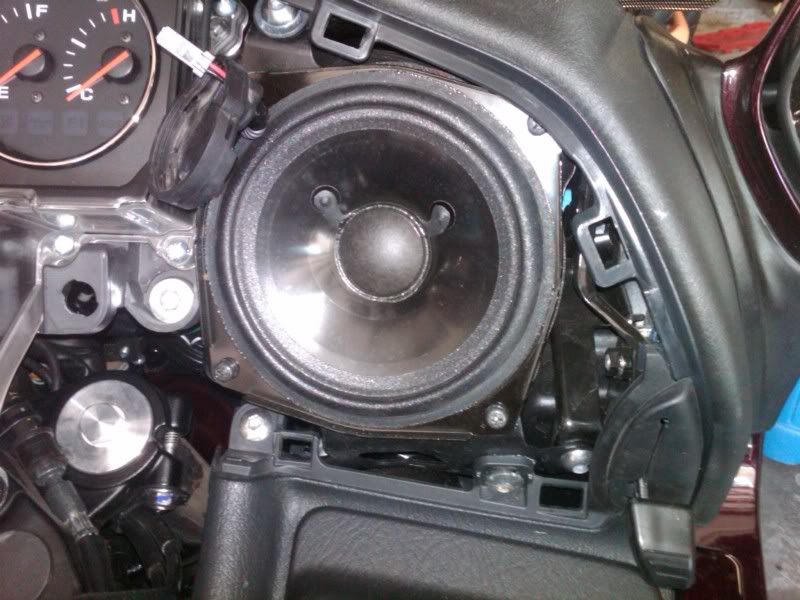

Ok so now I know that the speakers up front have one input that is split and the same signal is ran to both the tweeter and woofer on each side.
I also found that the entire speaker box up front seems to be connected, there is free space connecting the right and left side, they share the same box. this box also appears to be pretty sealed with the exception of the molded holes that the speaker leads run thru, it is about the size of a finger.
I tested the old and new speakers, one new and one stock both connected and hanging loose out of the boxes. The stock speaker seems to be louder that the polk while just hanging there and the polk is much less distorted and clear.
I push them in the speaker holes to test them as if they are sealed and mounted. there is a major difference in clarity between the two. But they are fighting each other because they share the same space. This is all the testing I can do for now till I can get the other side in.

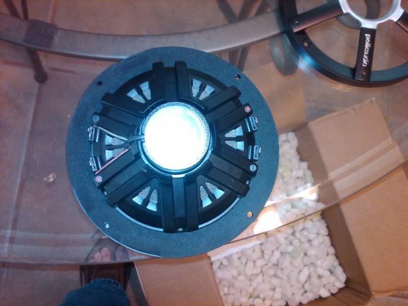

Now for the fun part. What I had to do to get the mm651 to fit. due to the extra depth of these speakers, you will need to use the extra mounting ring that comes with them. You will have to trim all the tabs off the ring and also cut some of the edges to square it up some where it hits the meter panel and the metal braces around it.
The speaker also needs to be "Squared up" to fit. The mm651 has a some kind of brittle composite basket, there is no metal. I used a pair of wire cutters to trim both the ring and speaker it really is not that difficult, just nibble at it and try to fit it till it clears everything.
Once I had it trimmed, i had to drill 4 holes to mount the rind to the metal housing that holds the shelter and all it surrounding parts. Once that is mounted, I fit the speaker in the ring and lined it up, drill 4 more holes to mount the speaker to the ring and that part is done.

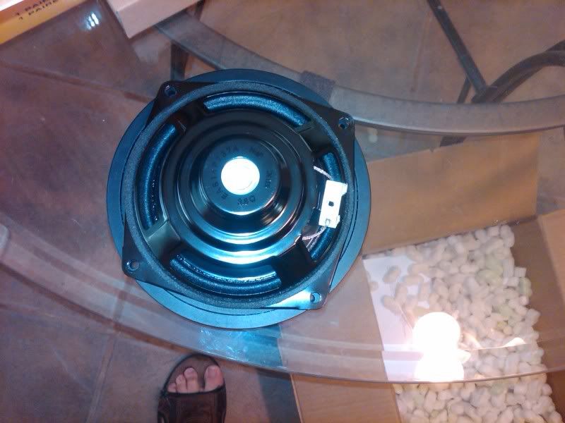

Here are a few pictures of the stock and Polk speakers side by side. The Polk looks bigger but they both fit the same 5" cutout. As you can see, the mounting holes line up perfect on both speakers when I put them on top of each other.

I am an idiot! I don't know why I didn't do this for the other side but I found a way to mount the speaker without drilling any new holes.
Take the STOCK speaker and line it up with the matching holes on the mounting spacer ring. Screw the ring onto the stock speaker and trace out the pattern of the speaker.
Unbolt it, use a dremmal tool and cut the ring in the squarish shape of the stock speaker and it will mount to the stock screw holes without drilling new ones.

Here is a picture of the stock front speaker system.
